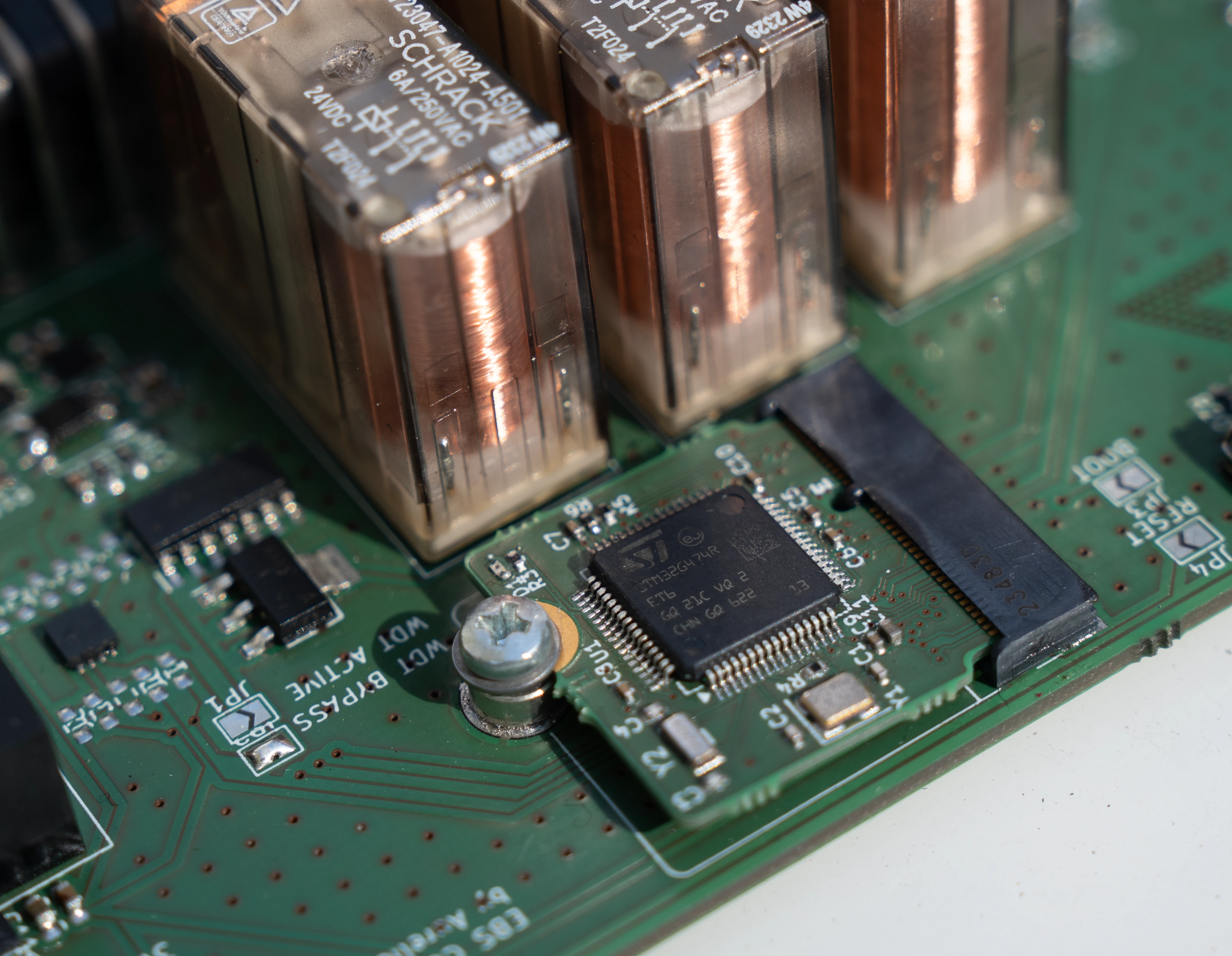

For our electronic control units, we needed a new core board.
To allow for the flexible replacement of microcontrollers, we use the Micromod form factor from Sparkfun.
In the past, we used the Micromod Teensy board to control our boards.
However, due to limited availability and hardware issues, we decided to build a Core Board ourselves, designing it completely according to our requirements.

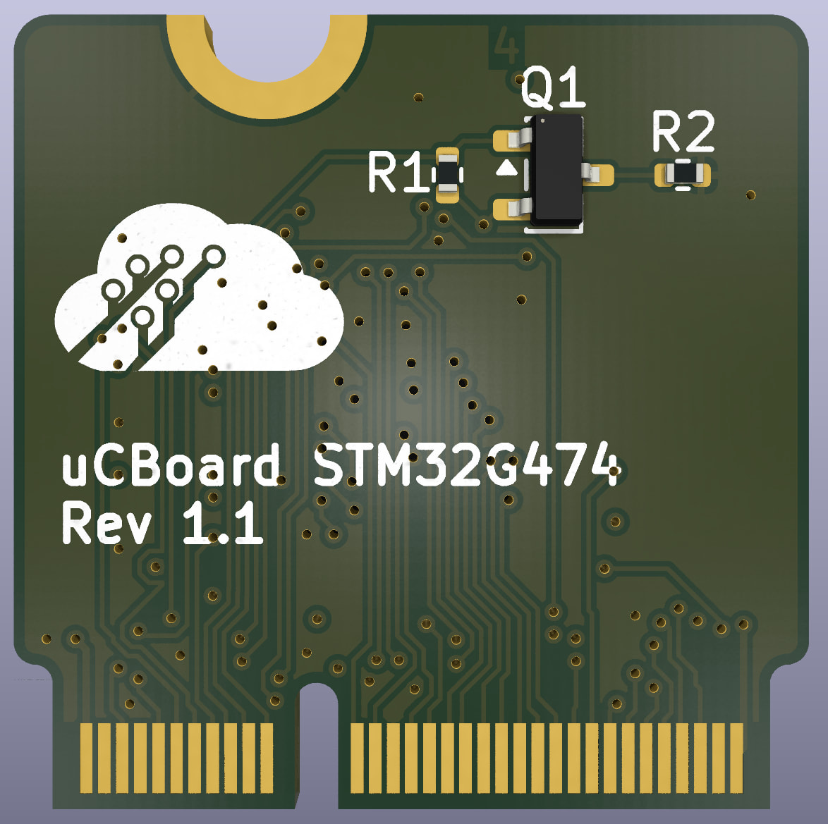

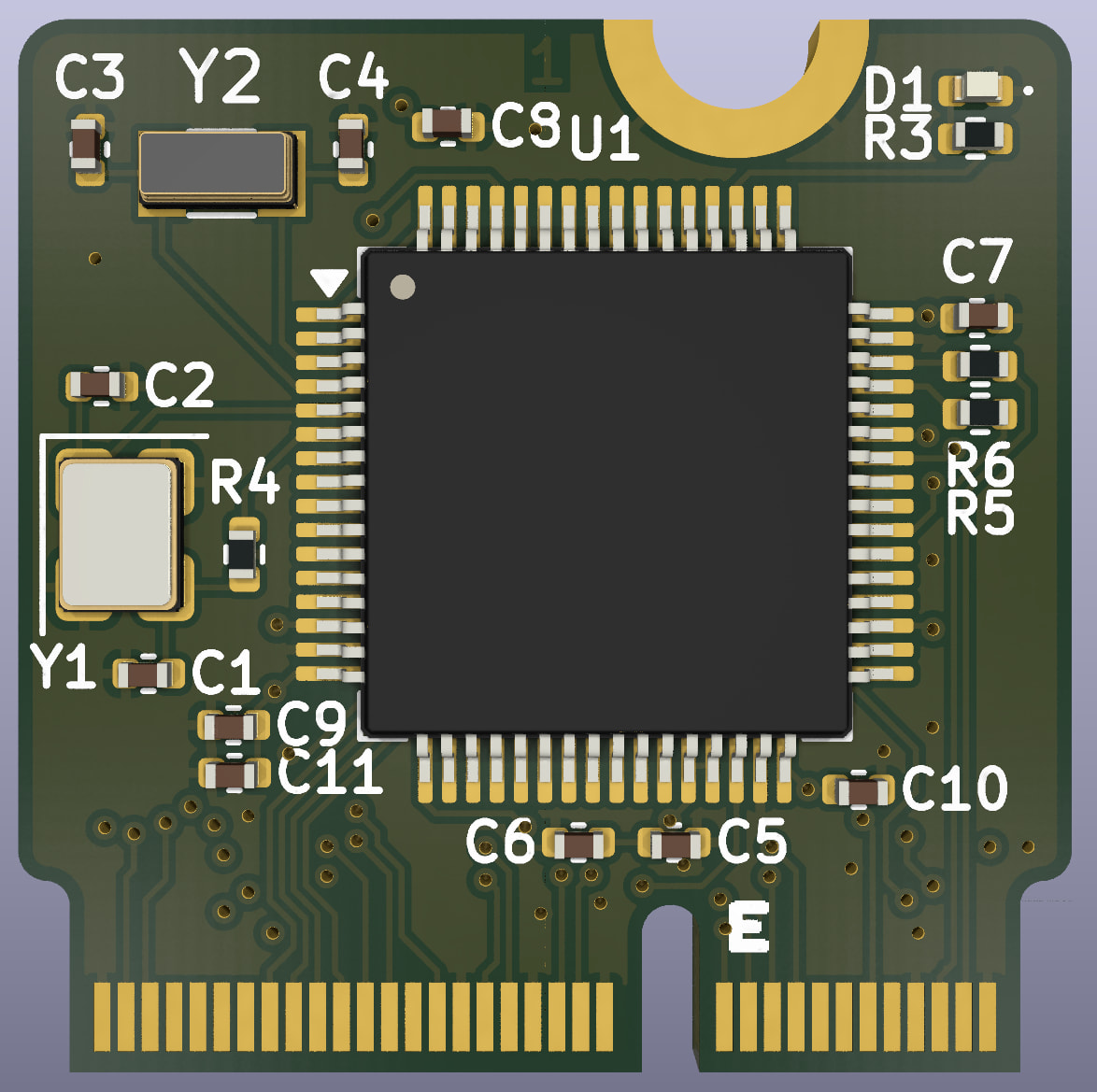

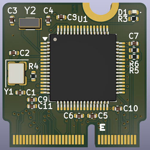

The solution: Building a custom STM32G474 Core Board
We built a custom Core Board around the STM32G474:
  • It offers a lot of processing power, with a clock speed of up to 170 MHz, precise ADCs, and three CAN controllers.
  • The board is a four-layer design with gold fingers and castellated holes.
