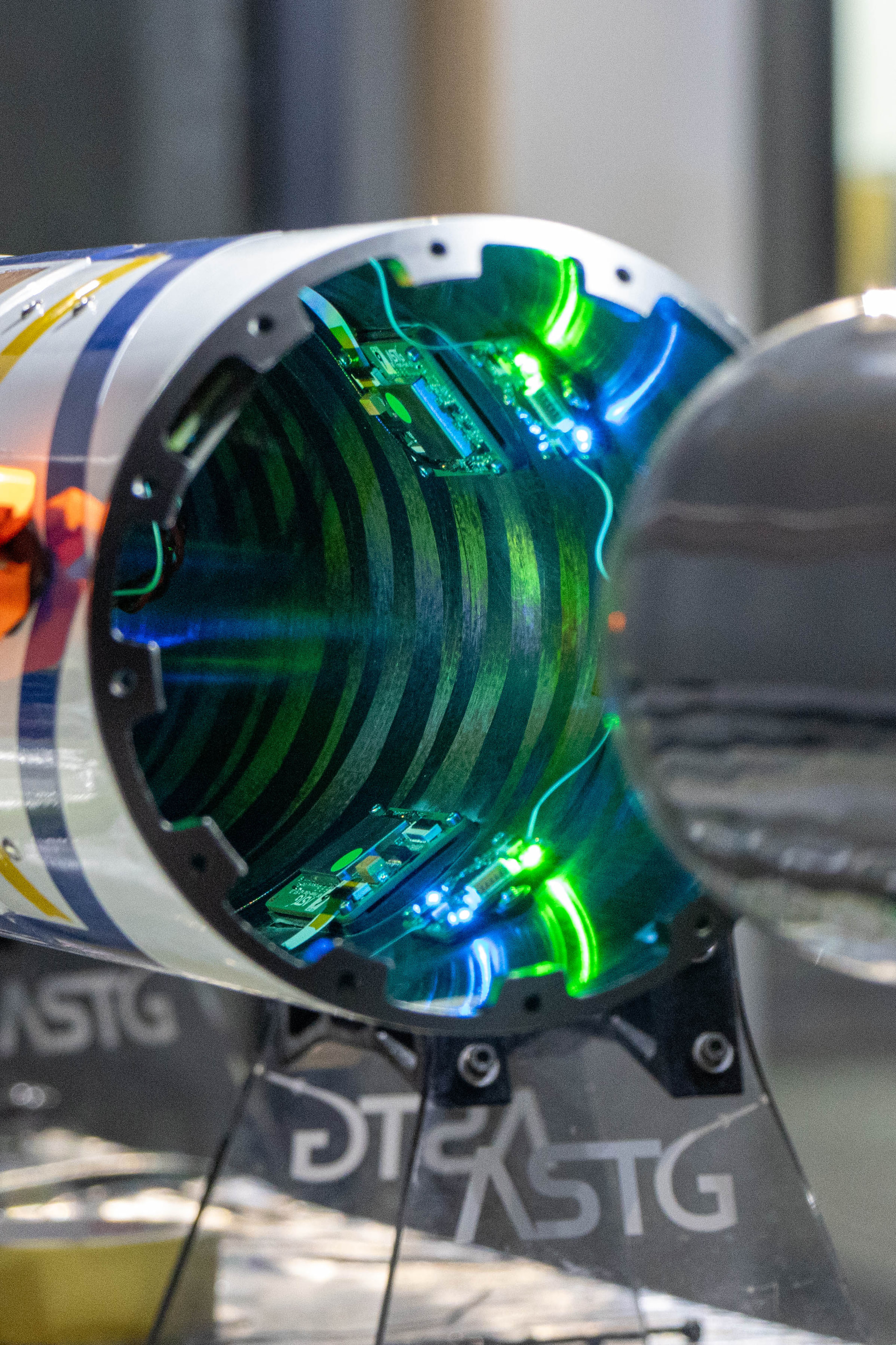

ISPIDA is the third hybrid engine project by ASTG, after Halcyon (2023) and Alcedo (2024) we aimed to reach the 9000 meter mark. ISPIDAs engine consists of a solid HTPB fuel with nitrous oxide as an oxidizer. The rockets systems are monitored, powered and controlled by 85 self designed PCBs located throughout the entire rocket.

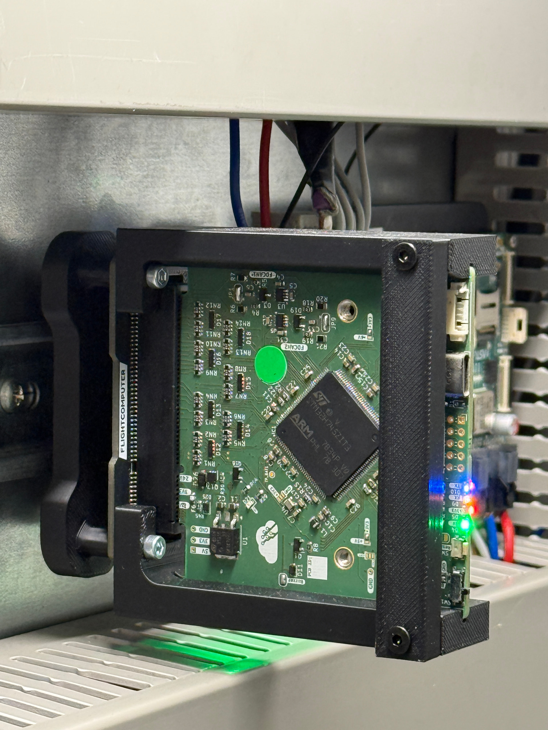

Our Main Flight Computer for example, is designed to monitor the propulsion system as well as actuating the recovery system of the rocket. Besides that, it hosts another smaller sensor board PCB which has additional flight critical sensors on it. Everything from IMUs to additional accelerometers and gyroscopes which feed our Kalman Filter with as much data as possible. Assisting the flight computer are two decentralized control and actuation nodes located in the propulsion stack. They communicate with the rest of the system via the CAN bus and send critical sensor data to the flight computer whilst receiving commands back.
ISPIDAs Flight Computer shown here in our engine test bed “Penguin”.

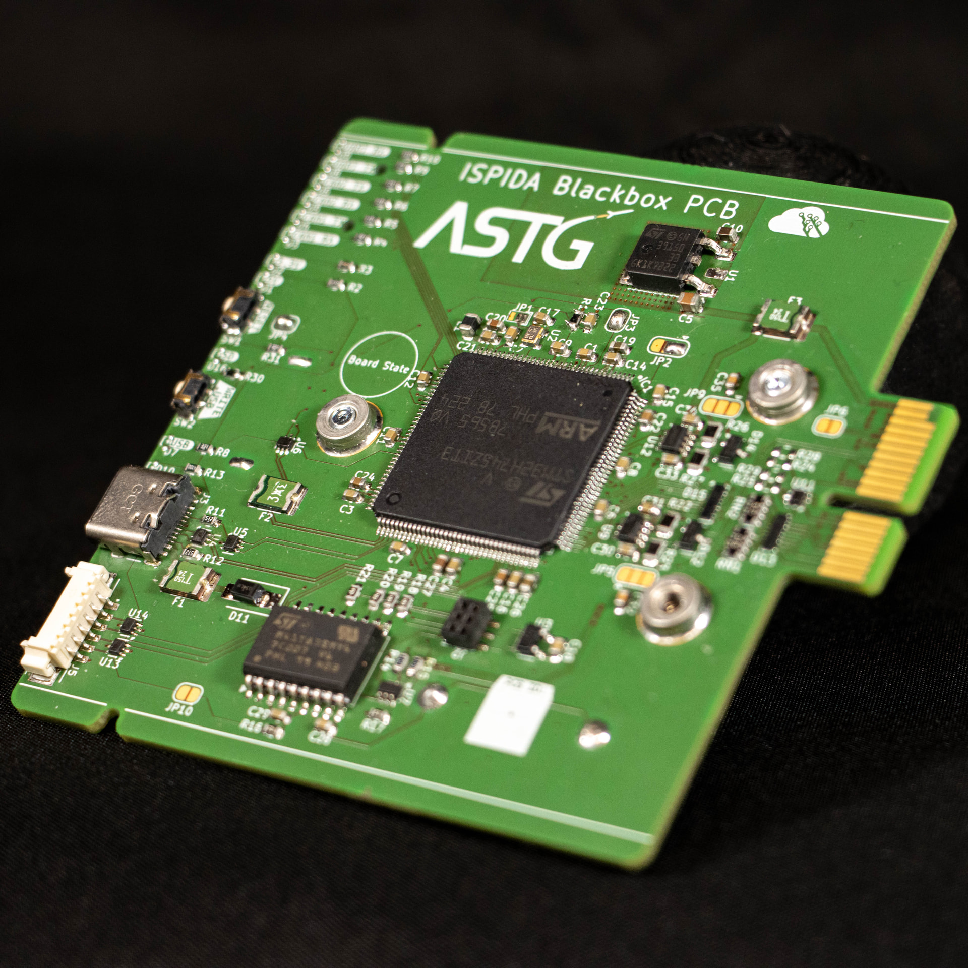

The various subsystems of our rocket all communicate over a CANbus with each other, the flight computer, the telemetry as well as our black box. The black box is here to do one thing: log all the data. All data packs of our custom communication protocol is written by the black box PCB onto a SD card which is encased in a carbon reinforced shell that is mounted on the PCB itself. In order to help us clean all the data after a test day or a flight, the PCB also hosts a Real Time Clock powered by a button battery to assign the data packs accurate time stamps.

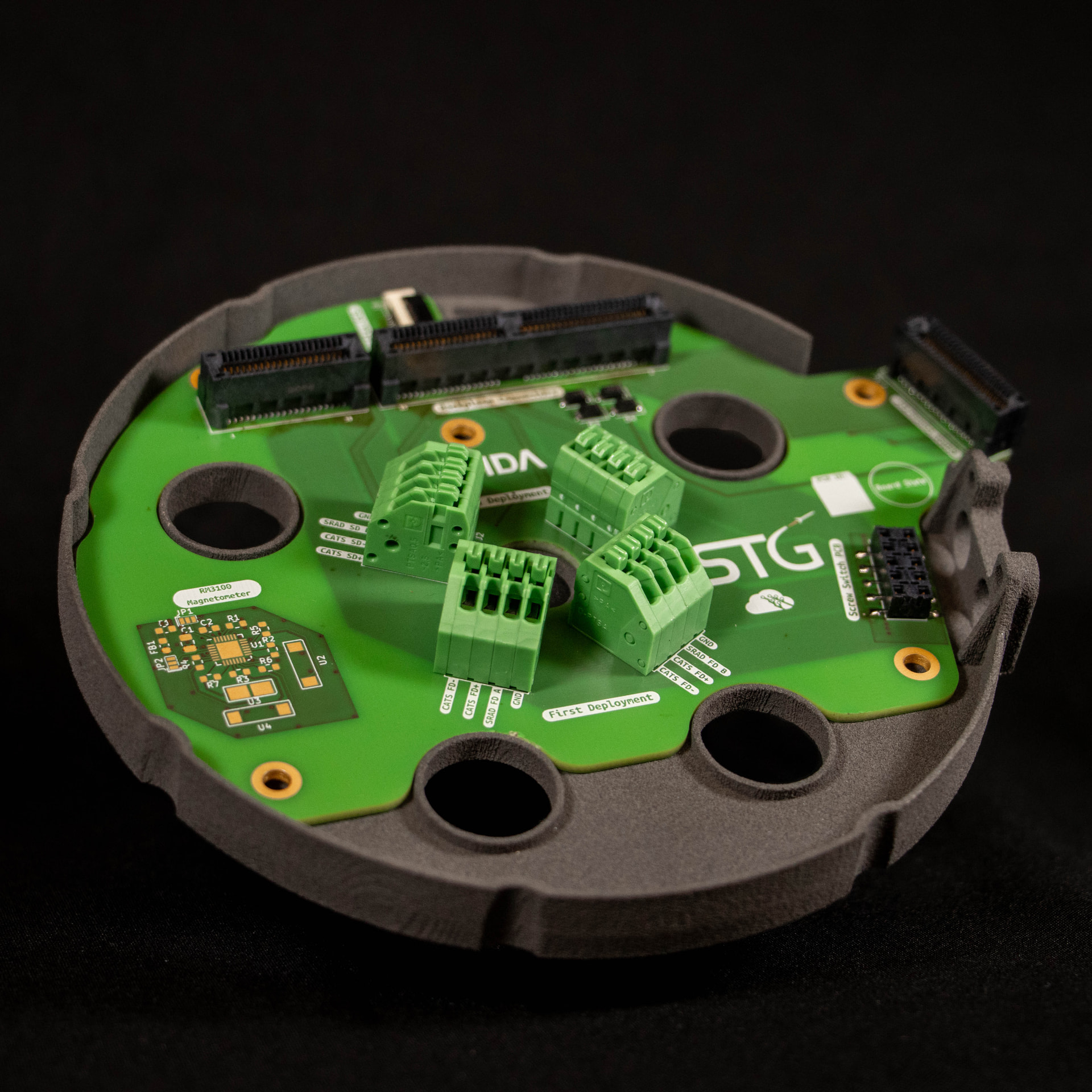

Another important PCB is the recovery interface:
It interfaces with our rockets backplane and the flight computer. It hosts the recovery igniter terminals which are used to actuate the first deployment parachute at apogee and the main parachute at around 450 meters above ground. There is a magnetometer located on the PCB to maximize its distance to high current circuits an their magnetic fields. The magnetometer provides us with additional data for attitude determination during flight and communicates via a I2C bus with the flight computer.
