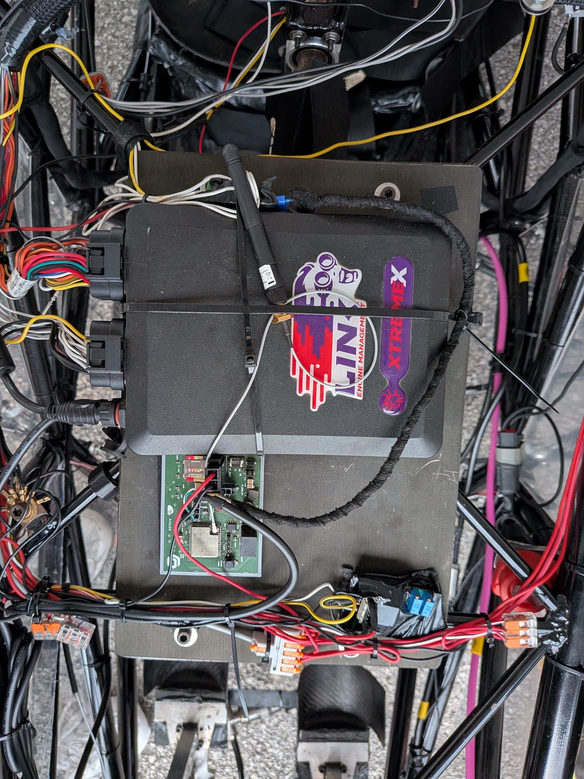

The board is a central telemetry unit built around an ESP32-WROOM-32UE. It reads our ECU, a Link G4X, over CAN at 500 kbit/s, writes everything to a microSD card, and streams the same data over WiFi to a TP-Link CPE210 access point at the pit wall.
Splitting it across three paths was deliberate. CAN does the acquisition because it is deterministic and it does not particularly care about the electrical noise inside a race car. The SD card means we never lose a session if the radio link drops, which it does. WiFi exists for one reason only: so we can see the car while it is still out there.

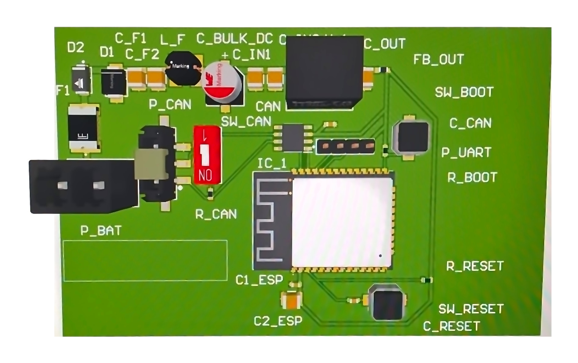

Some of the choices behind it:
Switchable 120 Ω CAN termination. A DIP switch instead of a fixed resistor. Our bus topology changes depending on which nodes are fitted for a given test, and I did not want to be reworking a board in the paddock at seven in the morning. Quick sanity check before every session: with two terminated nodes on the bus you should measure 60 Ω between CANH and CANL. If you read 120, one of your terminations is not where you think it is.
A GND pin on the CAN connectors. This one is small and it saved me an enormous amount of time. It lets me power the board from the UART header on the bench while it receives real CAN traffic from another node, with a common ground between them. I can develop and test the whole acquisition path sitting at a desk, without dragging the car’s battery into the room. If you are designing anything that talks on a differential bus, give yourself a ground reference on that connector.
Wide input converter, 6 to 36 V. Battery voltage on a car is not 12 V. It sags while cranking and comes back with transients, and I wanted the board to shrug at both. In front of it there is an input fuse, reverse polarity and transient protection, an LC filter and bulk capacitance before the switcher.
External antenna connector. The UE variant of the module exists for exactly this situation. A chassis is a metal box, and a PCB antenna inside a metal box is decoration.
Boot and reset buttons plus a UART header on the board. I added them thinking they would be a convenience. They turned out to be the only way I could flash the thing for weeks (see below).
Four things that went wrong
A damaged via in the power stage. I tore it while desoldering the buck converter, so the input rail was simply not connected any more. I found it with a multimeter, one point at a time, working backwards from the load until the continuity stopped making sense. Our electronics section chief repaired it with a flying wire.
A CAN transceiver soldered 180° out. Instead of the ~2.5 V recessive level I expected on CANH and CANL, I measured 0 V. Entirely my fault, and completely obvious afterwards, which is the most irritating category of mistake.
A reset capacitor larger than the manufacturer recommends. This is my favourite mistake of the whole project. I put a bigger cap on the EN line than Espressif specifies, reasoning that a cleaner reset could only help. It does not: the EN pin now discharges too slowly, the automatic bootloader entry via DTR/RTS stops working, and every flash needs the manual sequence of holding BOOT, pressing and releasing RESET, then releasing BOOT. The board works perfectly. It is just slightly worse to live with, every single time, because I second-guessed a number in a datasheet.
A network that simply refused to come up. I lost an evening to that one before it occurred to me that nothing on an isolated link is handing out IP addresses. The CPE210 in access point mode with no router behind it has no DHCP server. No lease, no connection. Everything runs on static IPs now.

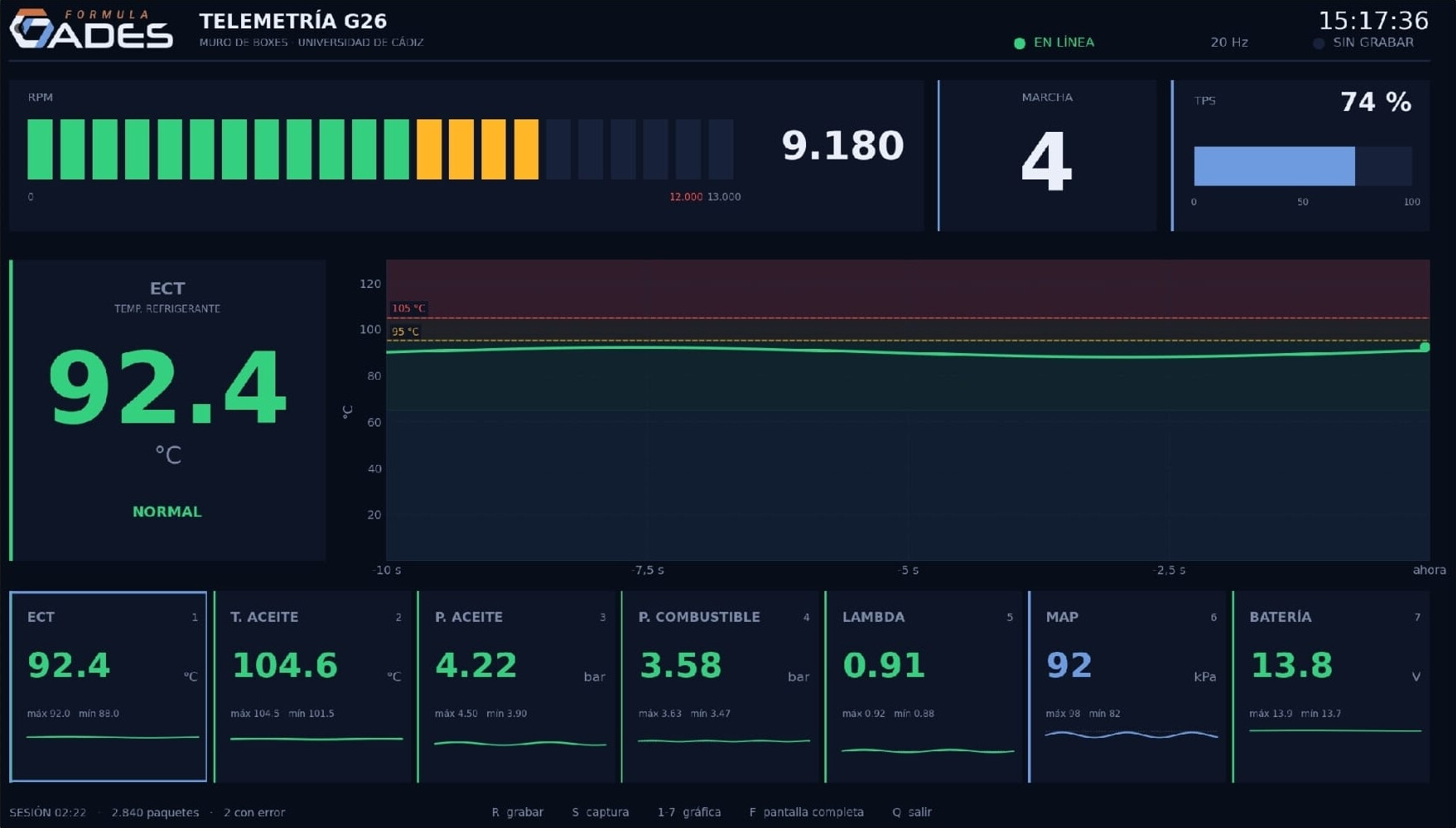

What the pit wall sees
The interface refreshes at 20 Hz: engine speed, gear, throttle position, coolant and oil temperature, oil and fuel pressure, lambda, MAP and battery voltage, with the last ten seconds of history and configurable alarm thresholds per channel. The session in the screenshot: 2,840 packets received, 2 with errors.
I have looked at that error counter far more often than is reasonable.

We measured a stable link at around 400 metres with the car at full throttle, which is more than enough to cover our pit area and a long stretch of track. Worth saying that this figure is conservative: during that test the CPE210 was mounted on the far side of the pit box pointing upwards, not at the circuit. The CPE210 is directional, with a 9 dBi antenna, so most of its gain was going into the sky and we still got 400 m out of it.
The car ran with all of this at Formula Student Spain, and it is at Alpe Adria this week.
