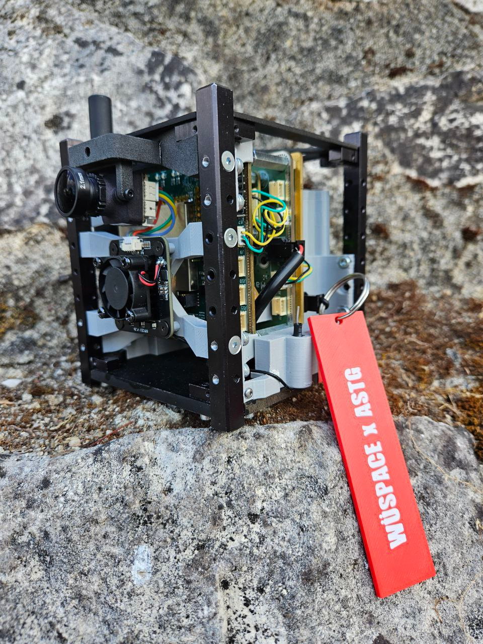

The project was originally conceived in collaboration with the student team from HyEnD Stuttgart for usage in their N₂ORTH hybrid propellant rocket. Since then a preliminary version of the project named South Cube has flown as payload on the Ispida rocket build by Aerospace Team Graz (ASTG) and further options for collaborations with student teams are being explored.

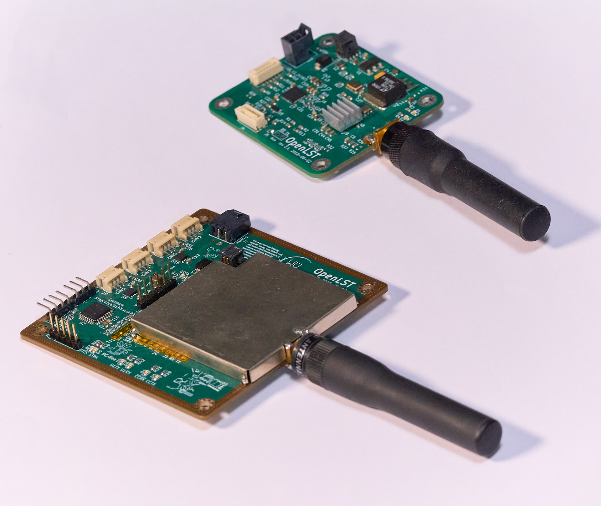

Underneath the LST (telemetry sender) is located. It collects the relevant messages from every other board via the CAN busses and sends this telemetry to the ground station. It uses a 437 MHz radio down-link.

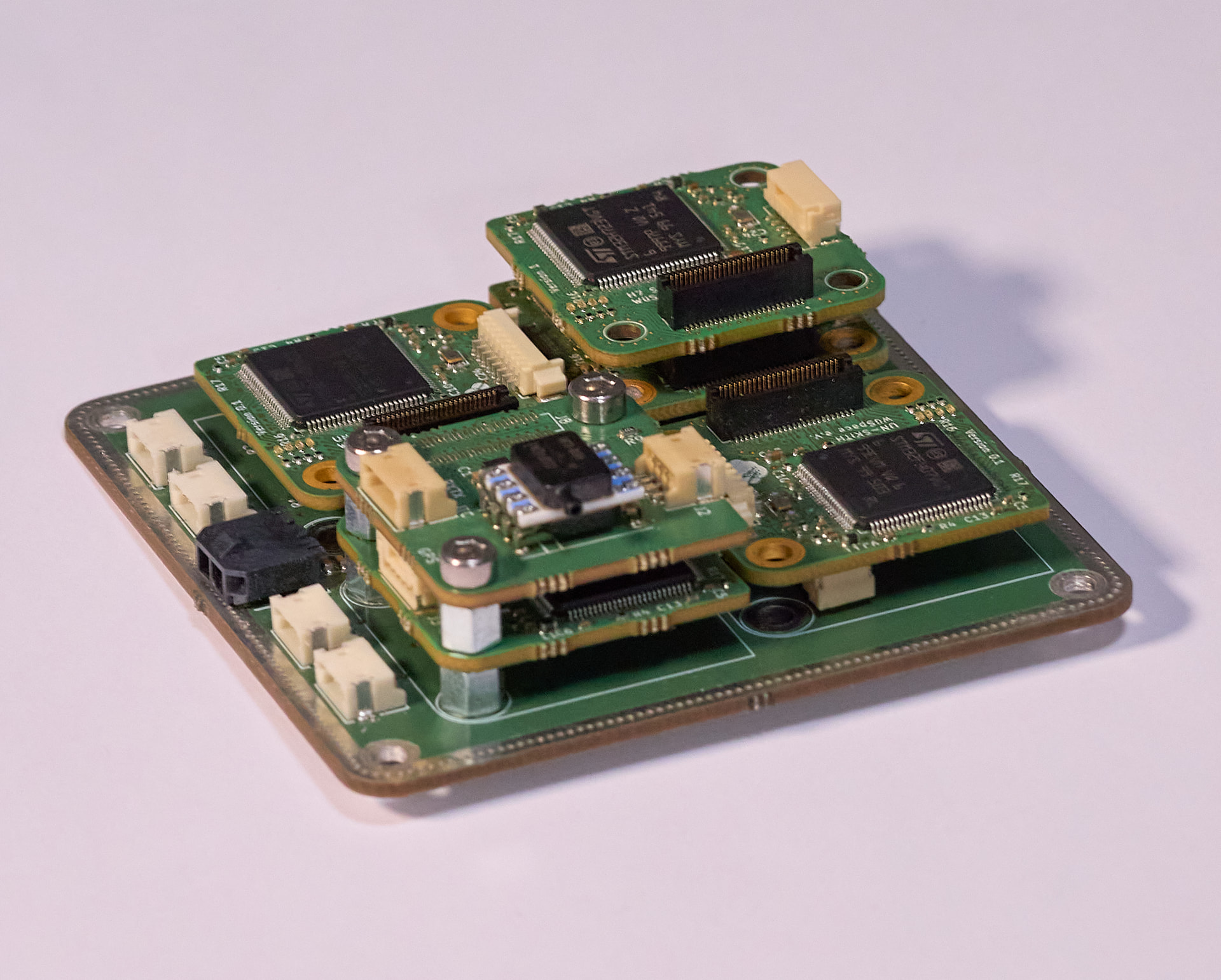

Most of the data which are send by the LST are measurements from the Upper-sensor-board. This is the Main-board with two imu’s, a magnetometer and a barometer. One aim of N₂ORTH is to reach a height over 100 km, so we need all of these sensor to determine the actual height of the rocket.
The measured data is processed by our H7-Skith module, which is based on the STM32H723 microcontroller. The core concept behind these two boards is their modularity: they can be stacked in various combinations to create flexible system configurations. On the H7-Skith, a Kalman filter is implemented to estimate the system’s pose based on the measured data.

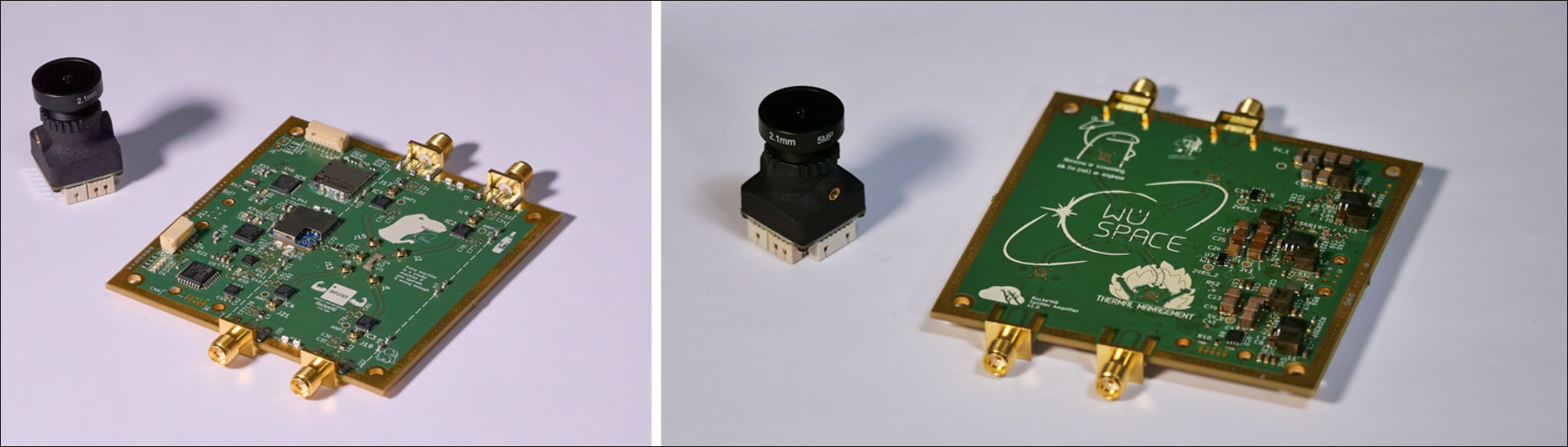

In addition to the sensor data, a live video stream is transmitted over a 5.8 GHz wireless link. The RocketHD board captures the video using camera software based on the OpenIPC framework. We use a wifi module, whose signal is then split into four paths, amplified, and transmitted through four patch antennas.

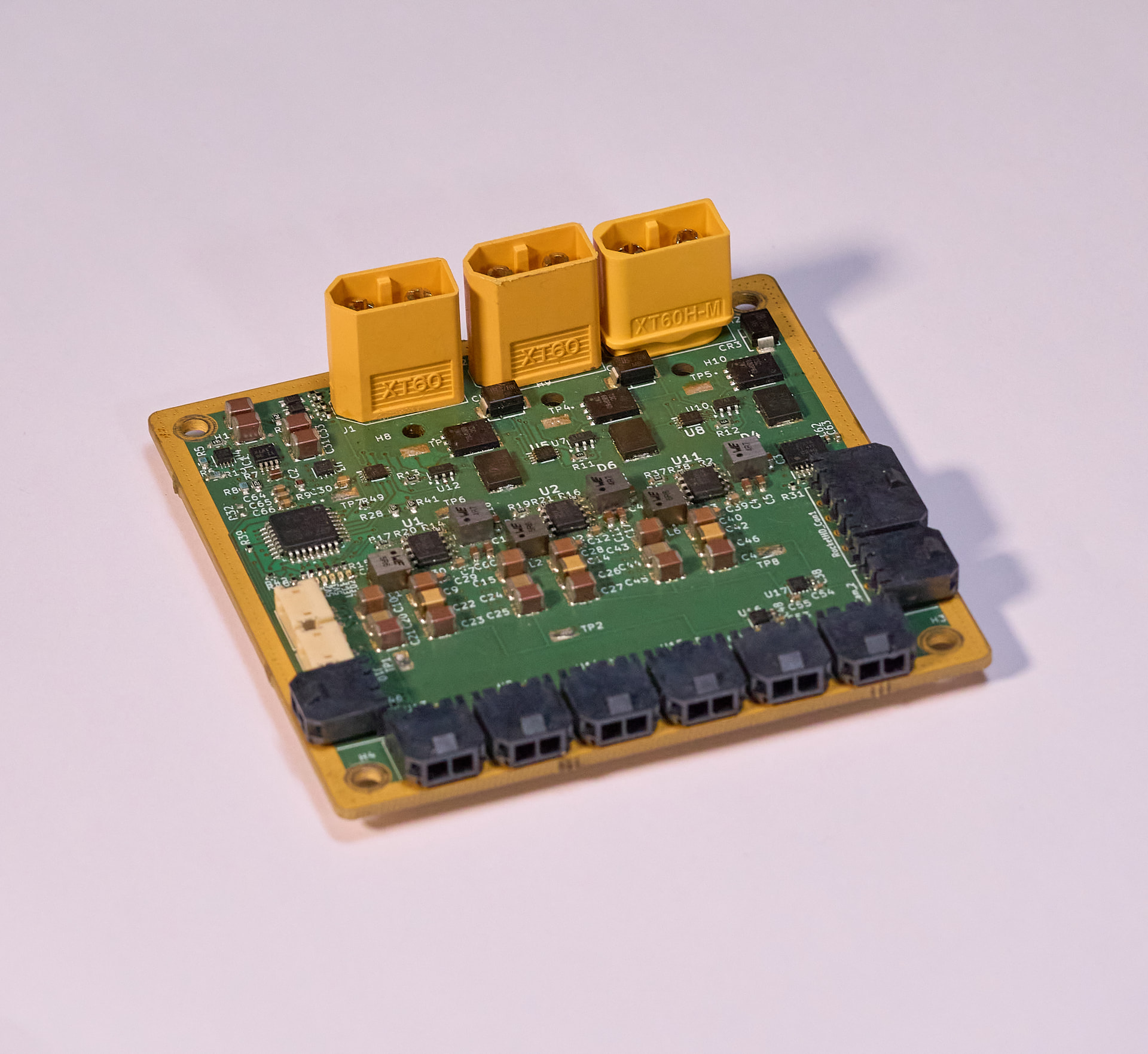

The EPS-board takes input power from two batteries and from the ground segment. It provides the flexibility to choose the most suitable power source or a combination of sources. After selection, the voltage is regulated to 5 V and supplied to all connected boards.
