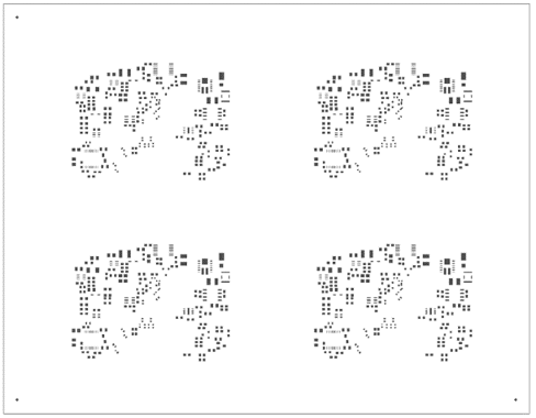

We provide solder paste data with every Simple Supply order. The data is provided as separate Gerber files for top and bottom assembly and includes global fiducials and panel outline.
Stencil openings in the Gerber file are not shrunk.
The bottom side stencil openings and fiducials are not mirrored!
