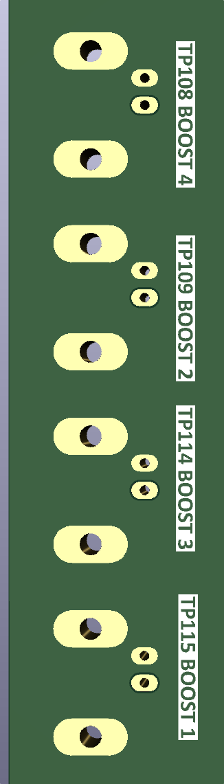

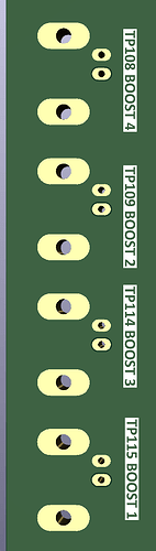

i have noticed a difference in the rendering engine:
How it should look like:
How your rendering engine displays it:

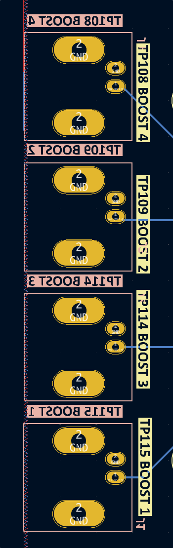

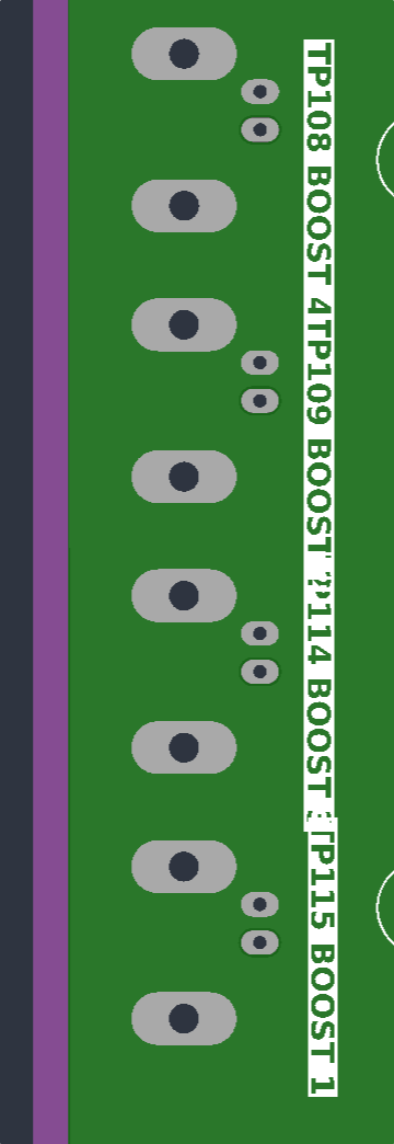

This is a known issue, if you’re using our plugin, the files are created locally and this should not happen then.
Just out of curiosity, which font are you using in this project @andreas-eet ?
It seems that’s the problem - we used Calibri and not the KiCad Font.
This makes sense as Calibri (and others) are Microsoft owned fonts. I added some replacements to our KiCad version for popular fonts. Please reupload your project to see whether this solves the issue.
It does solve the issue!
