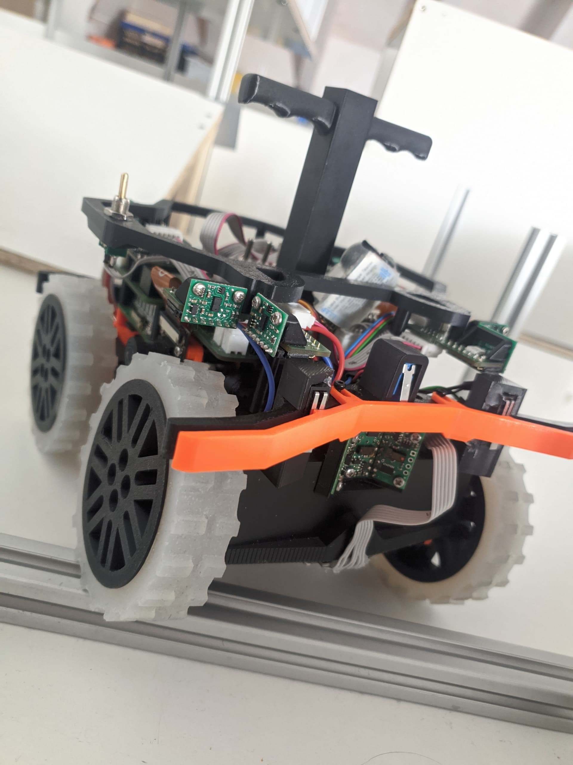

Our journey in the Rescue Maze started last year with a relatively simple robot. It was built using an Arduino Mega for the main driving and a Raspberry Pi, which handled victim detection via two side-mounted cameras.

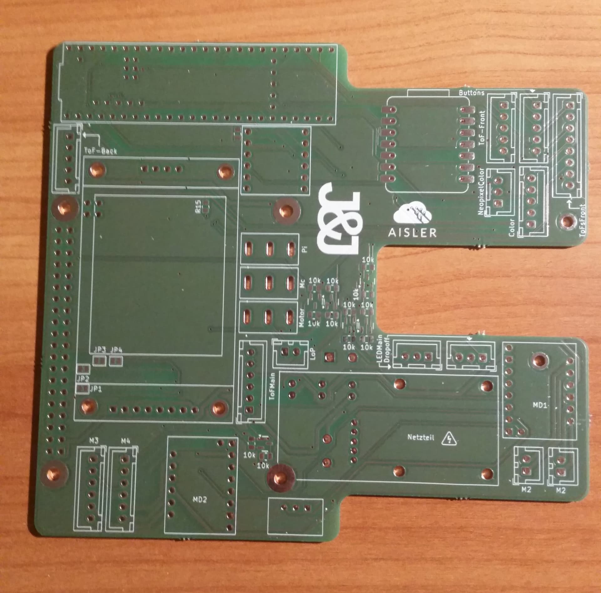

As our robot evolved in complexity, so did the wiring—and things got messy. The original setup involved several perfboards stacked on the Arduino Mega, which became increasingly unreliable. To solve this, and to upgrade to a more powerful Teensy 4.1, we decided to develop our own custom mainboard.
The new PCB was designed in KiCad, a fantastic open-source ECAD tool. It integrates all the necessary components—display, motor drivers, gyroscope, and more—on a single board, and features JST connectors for external modules.
This was a game-changer: the electronics became far more compact, organized, and reliable.

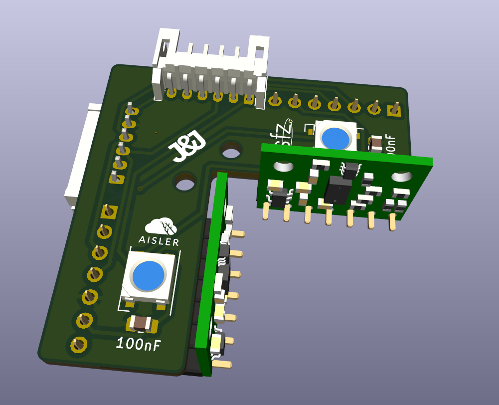

To manage the XShut pins on our Time-of-Flight distance sensors (used for changing I2C addresses), we developed a daisy-chainable PCB. Here, we got creative—repurposing the WS2811 IC (normally used for RGB LEDs) to control the XShut pins. Instead of lighting up LEDs, the IC now controls our sensor pins.
After the qualification round, we also developed our own color sensor board. Our goal was to quickly detect black tiles on the maze floor (representing holes), and adding a line sensor helped us do just that.
Thanks to Aisler Blitz manufacturing, we received our new PCB within just a few days—perfect timing ahead of the German Open.
