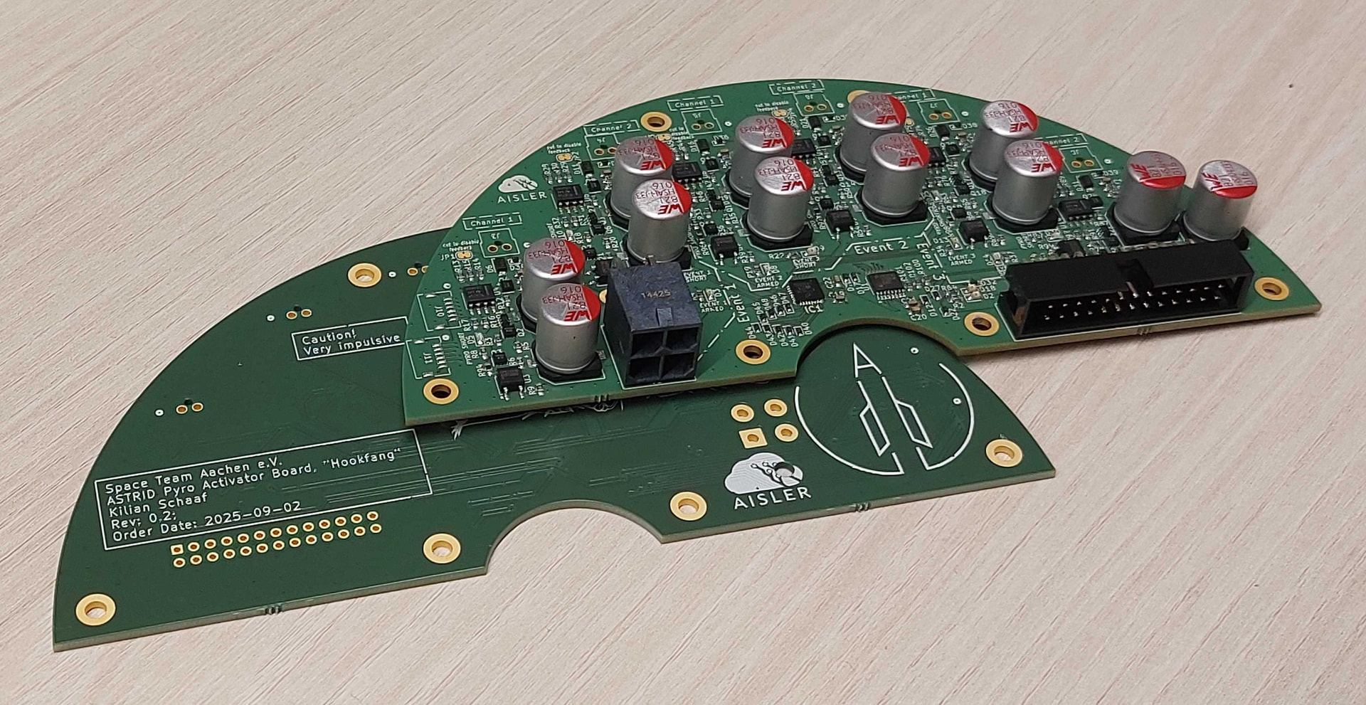

First and most importantly is the Battery Management Board. It controls charge and discharge of a Main Battery Pack and a Backup Battery Pack, between which can be seamlessly switched.

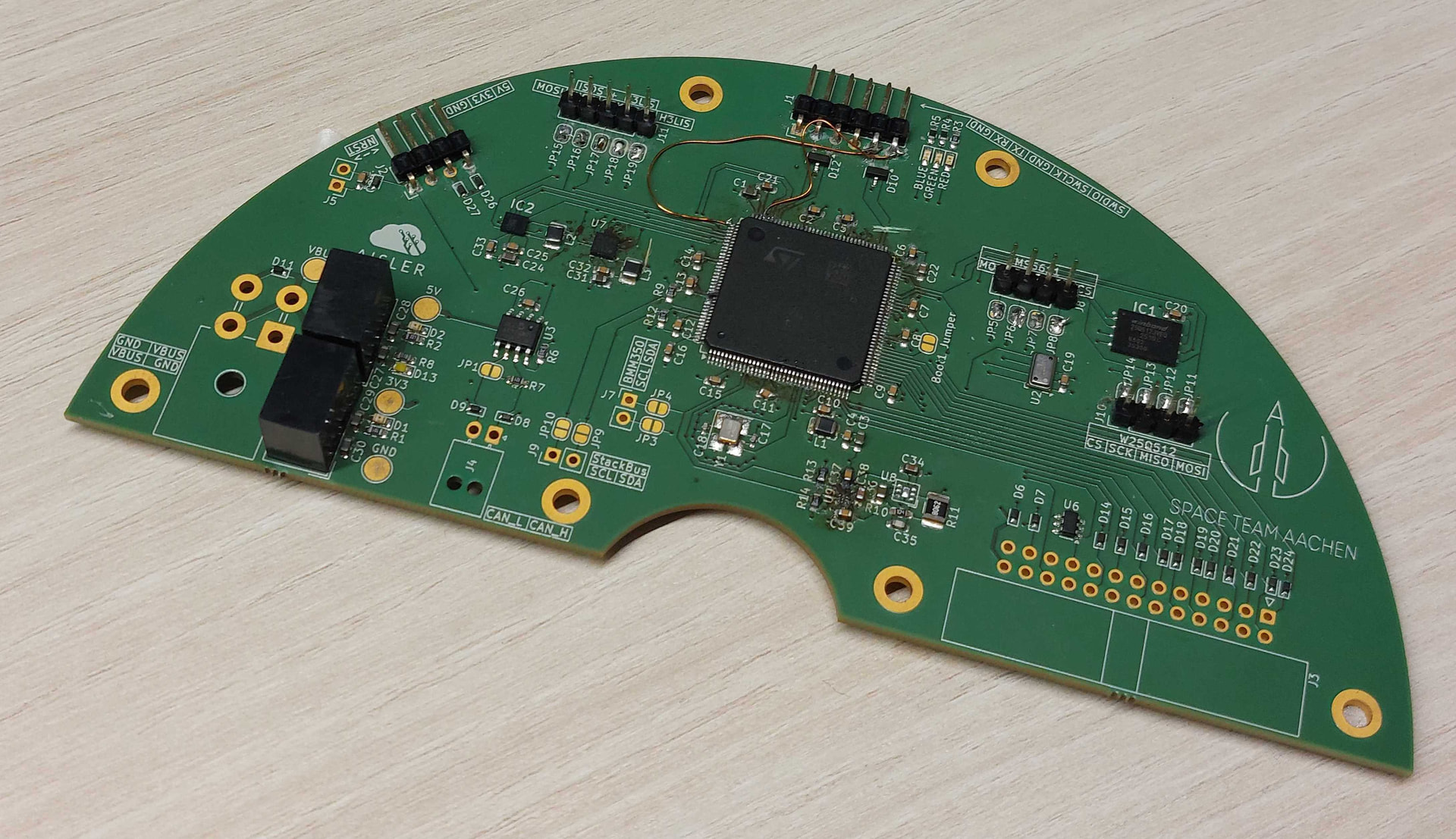

Secondly there is the Lonely Main Board. Originally two were planned for redundancy but ultimately the second one was deemed unnecessary and therefore it now is lonely. This board houses sensors for and runs the state estimation, in addition to the control algorithm for the airbrakes. It also connects to minion boards the first of which controls fluid system sensors for the oxidizer and active pressurization system, as well as a second board to supervise and activate pyro charges.

Even the best analytics tools can not protect against wrong pinouts though. This was learned the hard way, when we noticed our main board microcontroller had the wrong pins connected to the programming connector. Luckily nothing that could not be corrected with a few jumper wires and cut traces, nonetheless a pretty embarrassing error.
