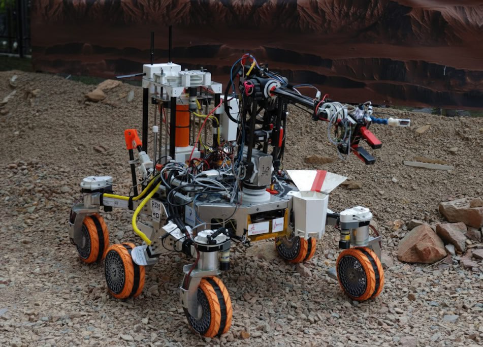

We are Sapienza Technology Team, a branch of SASA (Sapienza Aerospace Student Association) from University of Roma la Sapienza.
Our team’s objective is to design rover prototypes capable of autonomous navigation, sample analysis and maintenance operations using our 6-DOF robotic Arm and sampling modules. We have been participating to the European Rover Challenge for 4 years, and each year that passes we are pushed to improve our designs to keep up with all the other competitors. In order to do that, we are often forced to think outside of the box for most of our systems, and this year was no exception. Today we’ll show you how we’ve managed to get additional features on our stepper motor-based robotic arm, reducing cable clutter and using wireless communication within the system itself.
While the movement of the various joints is assigned to a simple yet effective ESP32-S3 breakout board located at the base of the robotic arm, we’ve decided to push our technical limits by developing a separate board mounted on the end effector itself. This has allowed us to implement more sensors and actuate the end effector separately, all while reducing the cable clutter coming from the base.
