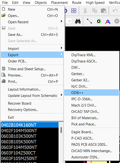

Import DipTrace designs using ODB++ export
Open up your PCB file and make sure all planes and polygons are updated, make sure to run the DRC to catch any errors, if there are any please resolve them.
If that is done navigate to ``File β†’ Export β†’ ODB++`
A new window will open up, there you can set the layer and coresponding output layers.
Unless you use a custom layer setup use the preset.
In the Settings part of the window set the Solder Mask Well and Paste Mask Shrink to zero, we will adjust these values for you automatically. Setting any other value than zero will cause issues.
Lastly check the box to export your ODB++ output as compressed file.
Click Export and save the file to a suitable location. You can now upload the archive file to our website and order your boards. :partying_face:
