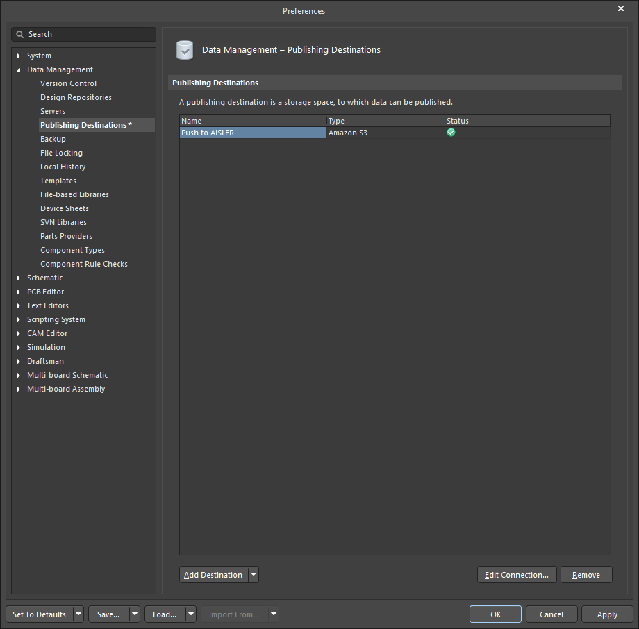

  • Open the “Preferences” dialog by clicking the preferences_btn button in the upper-right hand area of the design space.
  • Select “Data Managment” → “Publishing Destinations” from the menu on the left.
  • Using “Add Destination” add a new " Amazon S3" destination.

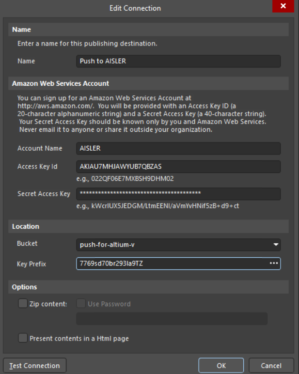

  • Fill out all input fields as shown in the screenshot.
    Name: Push to AISLER
    Account Name: AISLER
    Access Key Id: AKIAU7MHJAWYS2D2S72Q
    Secret Access Key: WsFi+CTtE5wdKAKoizvt8UDRAgK+VObIPFgZopLX
    Bucket: push-for-altium-v
    Key Prefix: Paste the “Organization Access Key” from your organization’s general settings as described in the first step.
When updating from the Gerber based Outjob make sure to uncheck Zip content !
Confirm the form. A new publishing destination should show up.

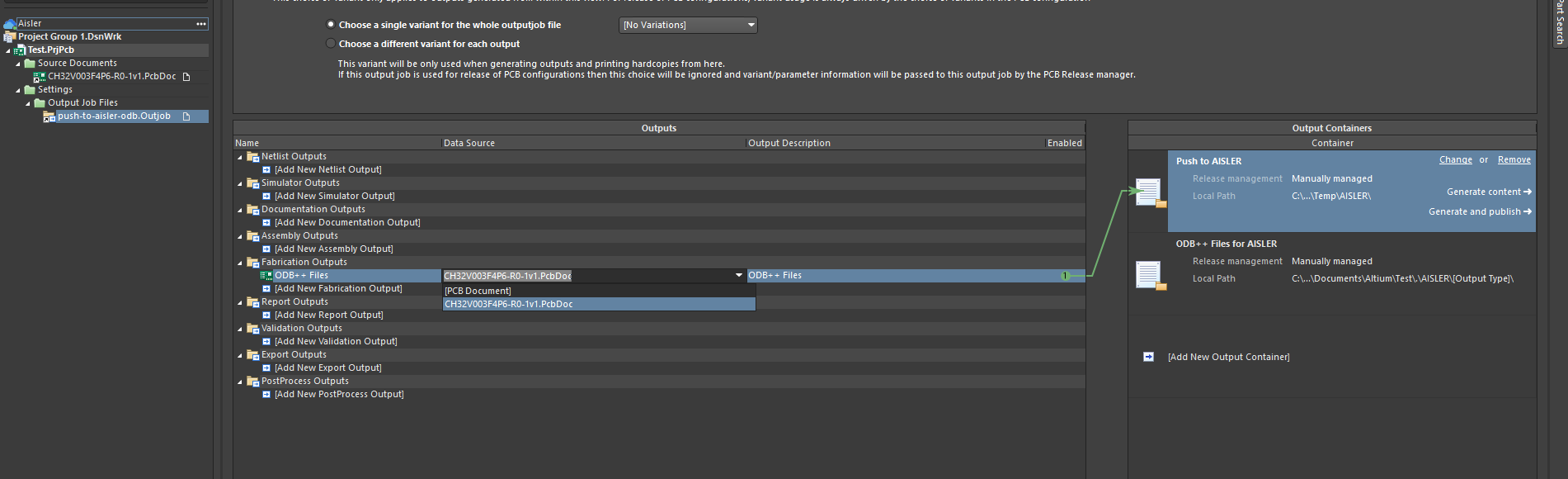

Using “Add Existing to Project…” on the “Projects Panel”, import the Outjob configuration to your project and assign the layout you would like to submit.

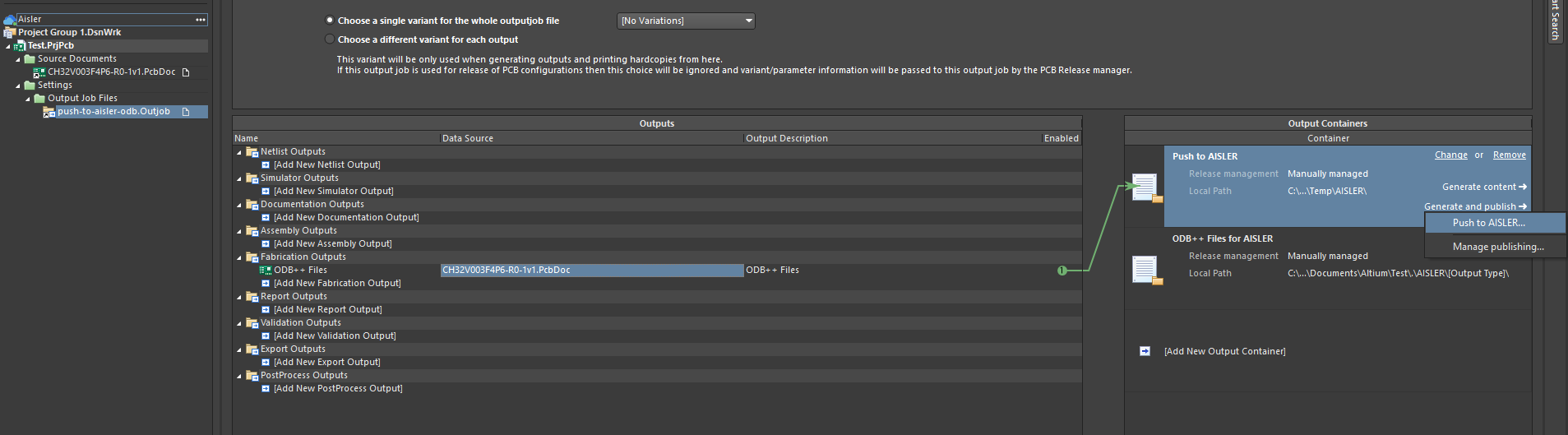

On the right hand side of the Outjob form, click “Generate and Publish” and select “Push to AISLER…”.
After just a few seconds a prompt should open up. Enter either a new project name (“Awesome Project”) or copy an existing repository / project path (“sandbox/awesome_project”).

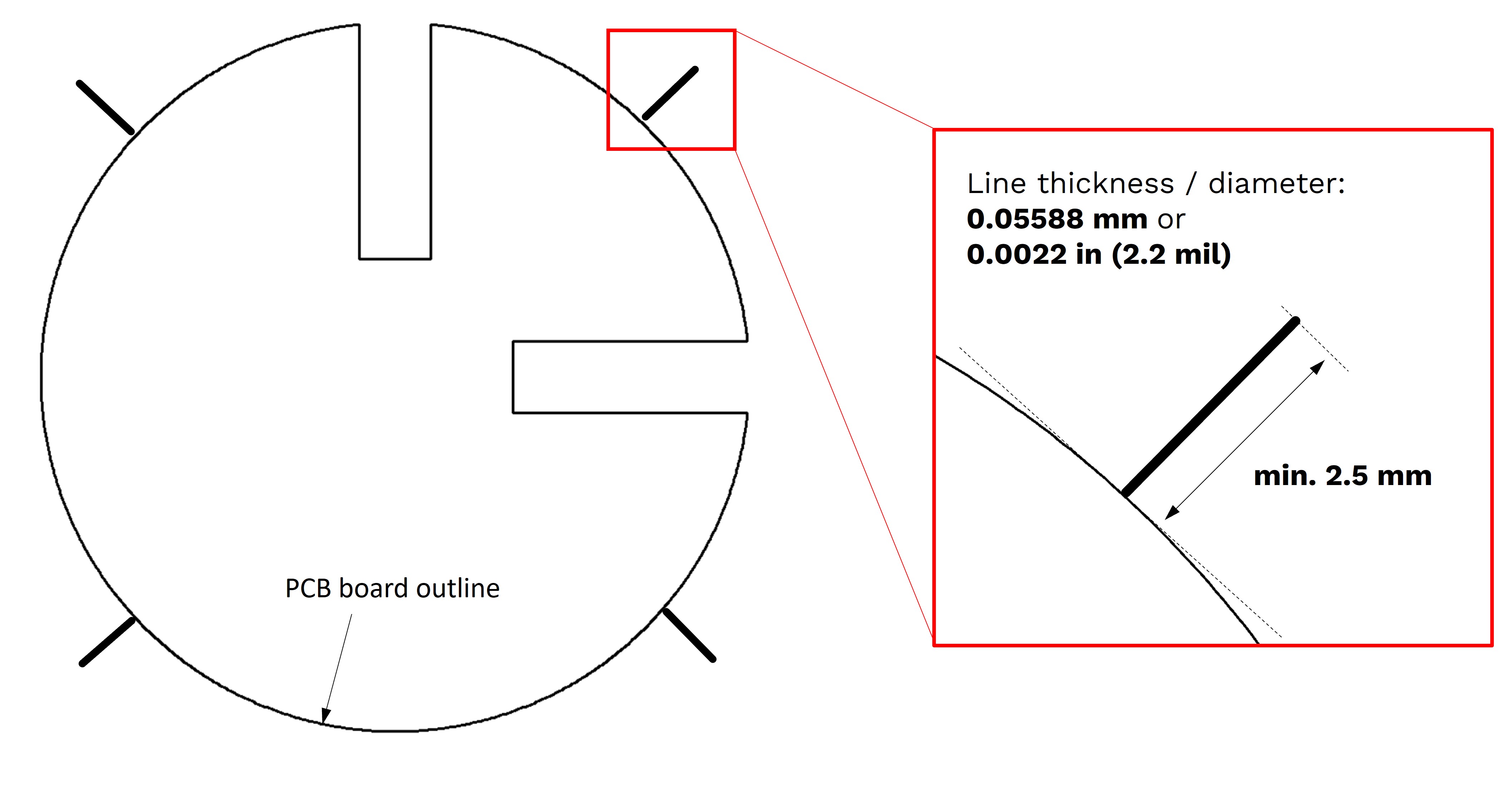

To set the position of custom bridges you’ll have to draw a marker on a layer that is named aisler-bridges , you can either rename an existing mechanical layer or create a new one.
Important: The aisler-bridges layer needs to be included in the OutJob configuration, it is not selected by default.

  • Head to Preferences → Data managment → Publishing Destinations → AISLER Push.
  • Click on Edit Connection
  • Under Options unselect the Checkbox Zip content.
  • Save the Settings.

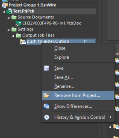

Step 2: Removal of the old Outjob from the Project.
Navigate in your file structure to
Select Exclude fom project.
Navigate to the file location and save the Outjob at a different location. In most cases the ODB++ is the better choice but during the transition period there might be things that not work, thus keep the Gerber.
