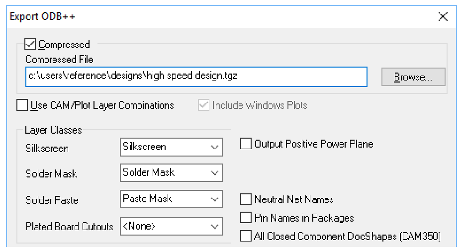

If that is done, navigate to ``the export menu and select ODB++.
This will open a window with a few options. There you can set:
Wether or not the ODB++ files should be compressed.
The location the files will be saved to.
Setting Layer Types.
You need to assign the Silkscreen, Soldermask, Solderpaste Layers!
Otherwise, your board will be manufactured without Soldermask or Silkscreen..
If you do not define the Solder Paste Layer, we are unable to manufacture a stencil for you.
It is mandatory to define the Solder Paste layer if you order an assembly.
Tick the Output Positive Power Plane checkbox if you use a PCB with internal copper layers.
The Plated Board Cutouts Layer needs to be assigned if you are using it in your design.
Leave the Compressed checkbox ticked, so you donβt have to manually compress the files before ordering.
When everything is set up, press OK and save the .tgz file. Now upload the file to our website, we will automatically generate the production data from it.
